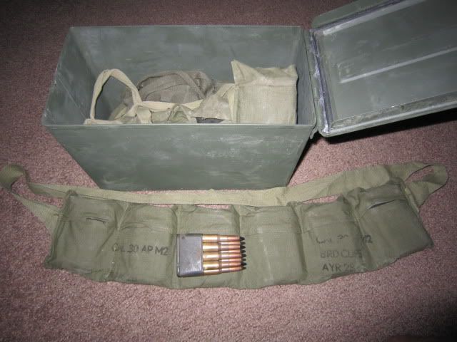

Well, 5 cans of AP came to the door the other day -- 192rd per can packed in bandoleers in Garand Clips ... 2 cans per case ... received 1 can shipped separately

I have the AYR lot.
After a case head rupture I am going to be pulling it.
I am not hearing good things on the interior case condition.

lot 23. ayr 55
it chrono's 2800 - 2890 fps
The head has 6 holes in it. I will dig up the pictures soon. I want to dissect some of the cases to look at the thickness.
Rumor has the powder might have had too much moisture upon loading.
I am just going to start pulling it apart, and drying the powder out and making new ammo with non-corrosive primers.
Ive had good luck fixing the dented HXP spam can ammo this way.

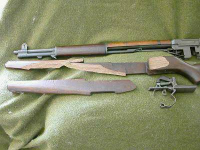

I have seen 2 1903-A3 rifles blown up because of Kynoch .30-06 M2 Ball manufactured 1959-60. I wonder if they have tested this ammo? The brass cases had poor annealing and the heads split and blew the stocks off the rifles. This can also happen with any manufacutrer of Korean .30 M2 Ball. The French made .30 M2 Ball and the same problem is apparent in their ammo. In Pike County the French ammo destroyed a Rem 760 Pump and a Rem 700ADL. The 700 had the stock blown off it. The 760 had the action swelled and jammed. I observed these rifles personally. Remember, the CMP was offering Korean .30 M2 Ball for sale and recommending it's use until the guns started to blow up.
The Korean ammo has blown up 6 M1 rifles and 5 1903 rifles that I am aware of.
Below, is a photo of a nice M1 that was fired with Korean PS headstamped .30-M2 Ball ammo. Everyone should consider reloading ammo before using foreign military ball ammo. The rifle would probably be serviceable with the addition of a new stock. Can you imagine the flinchitis you would have after an incident like this.
