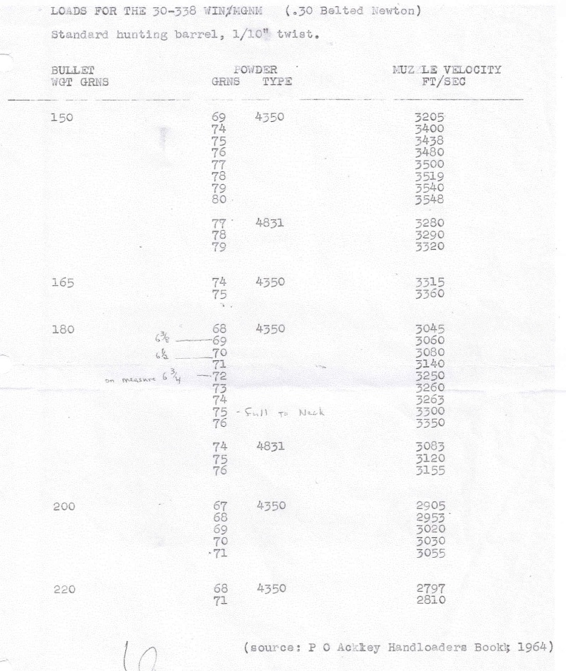

See below. These are from 1964. They are offered only as suggestions. At the time I had a custom 30-338 Win Mag made by E A Craven, Bend OR: Douglas barrel, FN action, French Walnut hand-checkered roll-over comb stock. My grandson has it now. I've got to get him to send me some pictures.
I have four other Excel spreadsheets with more detailed loading information (suggestions) that I would be happy to send you. If you will send me your email address I’ll send them to you as attachments.

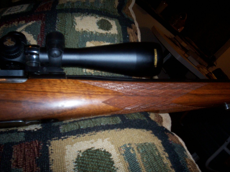

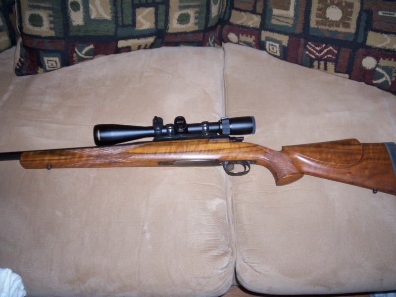

Well, they have arrived. So here we go. 30-338 Win Mag built for me by E A Craven of Bend OR (previously of Hanford CA) in the mid- to late-60’s - Douglas barrel, FN action, French Walnut rollover-comb hand-checkered stock. This is not the original scope. My grandson owns it now. And, I believe he has replaced the recoil pad. I don't think the original was that thick(!).
It was a pretty nice rifle (do miss it). A little heavy but that was OK.

Beautiful rifle Ed. I know it must bring back great memories. Not just of the good times but also of the black and blue shoulder. :) . I will try to get my pics up as soon as possible, may be wednesday .You have helped me with the loads for mine and I really appreciate it.
scott
It is beautiful...plus I'd almost forgotten what typewriter copy looked like, THAT brings back memories for me.
