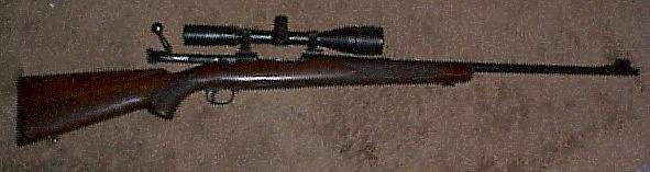

5,372 Posts
Accuracy is not a new technology
All this new technology is not new. I have a Winchester Prewar Model 70 in .270 WXF. It is capable of 5/8" groups at 100 yards from the bench (5 shots). I use a Burris Signature 8x32x44mm for targets and a Tasco 2.5x10x42mm for deer hunting. It is amazing how well the Tasco performs for a $60 telescope. The Burris is better but it is $600. In 1984, I used the rifle with a Lyman long slide receiver sight and a Lyman 17A globe sight, at our first over the course NRA 600 yard match at our club. The rifle was my Father's and I wore his old Fedora for the occasion. I shot 189 points at 600 yards from the prone position. It is truly an accurate rifle. THe rifle was assembled by Winchester in August 1937. The receiver was made in May, 1936. I was using 150 gr Sierra SPBT bullets with 54 gr IMR4831 and a Federal Match Primer.
The wood to metal fit on the rilfe is beautiful. The checkering is hand applied, and the action is smooth as glass. These features are not available on factory rifles any more. The Tasco 2.5x10x42mm is on the rifle.
Doug
