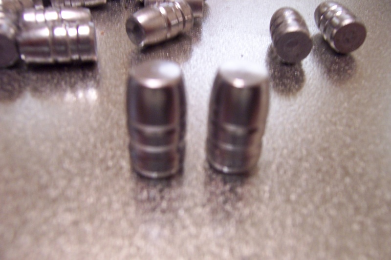

One a 124 grain 9mm .356 and a 158 Gr .358 (38 special). The 9mm poured great. I had a couple with wrinkles...but I was getting pretty good bullets after about 3 pours on a virgin double cavity mould.

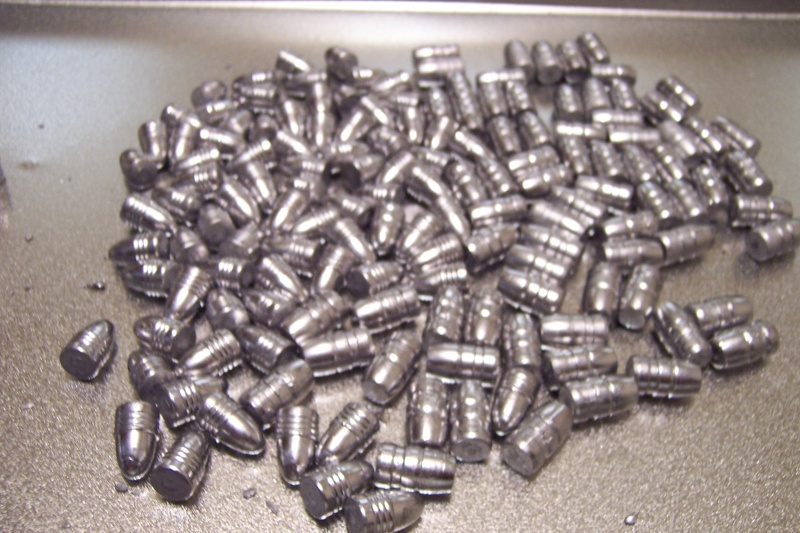

Used 3 cornbread that I melted last weekend that were listed above. Word was they might be lead heavy so for this batch I used 3 of my Wheel weight cornbread sticks and 1 Linotype...so only 4 lbs in my melting pot. I got enough to shoot a practice session...about 150 bullets I guess...was having a little trouble with the melt getting too hot towards the end of the pot with the 38's...a few frosted...

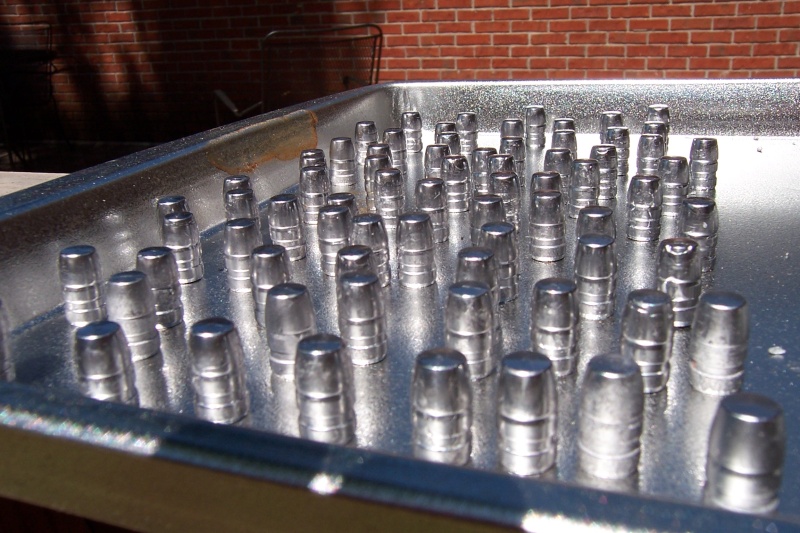

The 9mm's are Tumblelubes...suppose to be good to use through the cheap Lee sizer I have using Allox.
and the 158 gr 38's
Yeah I know the pics could be better

Neck, those are interesting looking 38cal bullets. Looks like they are bevel-based bullets. What cavity mold do you have for them?
Yes, some of the 9mm bullets in pic #1 do have "bad" wrinkles. The mold is too cold. Might be some of the first bullets poured.......

That is an interesting looking 38 boolit!!

Yeah I like my cheap Lee moulds...Weighed both the 9mm and the 38's and they are $.
Both of them released bullets as soon as I opened em...bet I only tapped em a couple times
9mm is a .356 124 Gr TL356-124-2R
38 is a .358 158 Gr 358-158-RF

Neck, with the tumble lubed bullets, you're getting the lube in the bore just as soon as the bullet jumps into the rifling. With lubrisized bullets, the bullets has to travel around 1/16 to 1/8 of an inch before the lube grove reaches the rifling in the bore. You're riding on lead for the first part of the trip down the bore. Just a thought.
