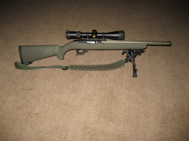

here is a pic of my girl for now, I left her in the safe for a while after the build and now its time to start back up on her. Gotta get a can and ND3 now with a Red power custom trigger, and skeleton bolt handle.
