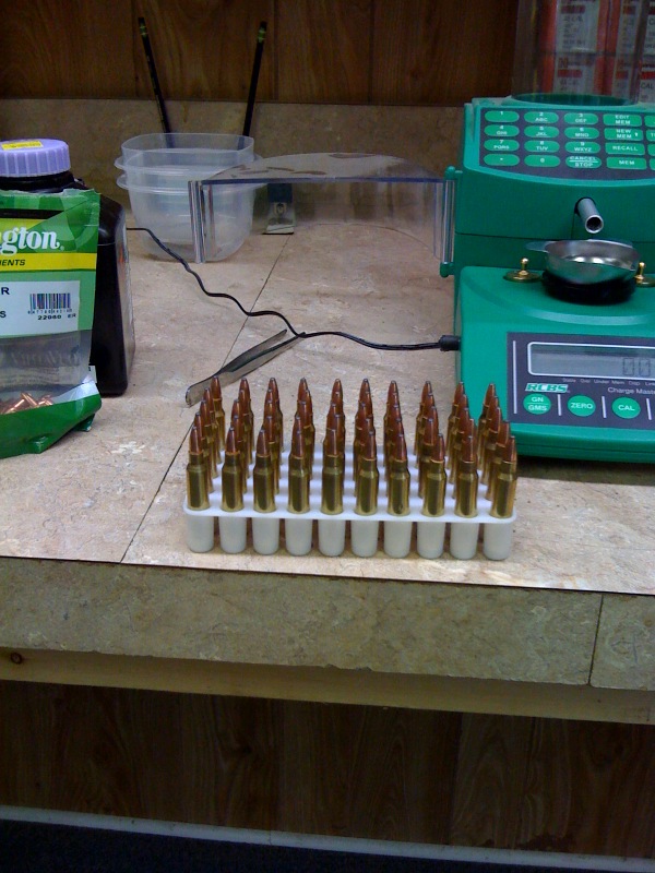

I finally got some loaded and ready to go! I actually have 66 ready, that is all the time I had today. The picture is of my first 50. I am biased, BUT, I have never seen better looking ammo!!!!!!! We used range brass, Remington 55gr. PSP, 23.5gr. H322, and S&B SR primers. I can't wait to see how they shoot!
Very good looking ammo you have there!! Let us know how they do ... There is a real satisfaction what you have created!!
