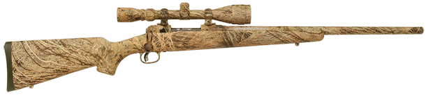

Found a load that my 22-250 likes so i figured id start varmint hunting with it, but i just dont like shiny barrels..
My buddy left some paint at the house from when he did his 10/22. Its all Flat colors, black, olive, brown, khaki.
Before:
After:
Never painted a gun, much less something i have this much money in. But i figured if i mess it up, its still gonna function properly. I used a ear plug and put it in the muzzle, it has a very good 1/8" clearance all the way around the crown so it worked good. I greased the bolt body so no paint stuck to it, it worked also.

It was krylon camoflage paint. It stuck pretty good too, it reminds me of that rifle savage has out. Ill find it tom.

Sgf, i hit the lens with a good coat of flat black so it wouldnt reflect :)

Yea it said it had Fusion in it..
I had to hit the barrel with some sandpaper to rough it up so the paint would stick.. That was the hardest thing to do, never had to be that mean to a gun..

Good idear, i like the scratched up, worn finish look. Gives it character, and its own look. I still got the rest of the paint in the shop. Thinkin hard bout doin my 300wm since its got the shiney barrel too.
I sprayed it down really good with brake and parts cleaner to get all the oil and stuff off. Hit the barrel with some sandpaper and put some wheelbearing grease on the bolt so i could wipe it off after the paint dried and it wouldnt stick. Did a really even base coat of flat black and then got to work.
