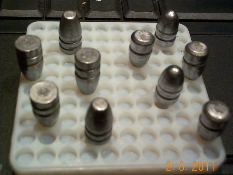

Re: Keyholing: 9mm lead 147gr. rcbs flat nose/flat base
To every 6-8 pounds of ingots(ww) I'm adding a 6inch piece of lead-free solder(95%tin) and another strip of harder lead-free solder which has 5% antimony. My other mold (same alloy) is dropping .358, but it is a whole nutha story.135gr.ones on the right hand side
check :thanks:
But the bevel base shoots perfect.(and you're right that is a cold-mold wrinkly mess on the right)
It's those flat nose Ba$*&#ds on the lefty-side that fly crooked. :evil:
(lil political-jab to the neck there for leftyz)
