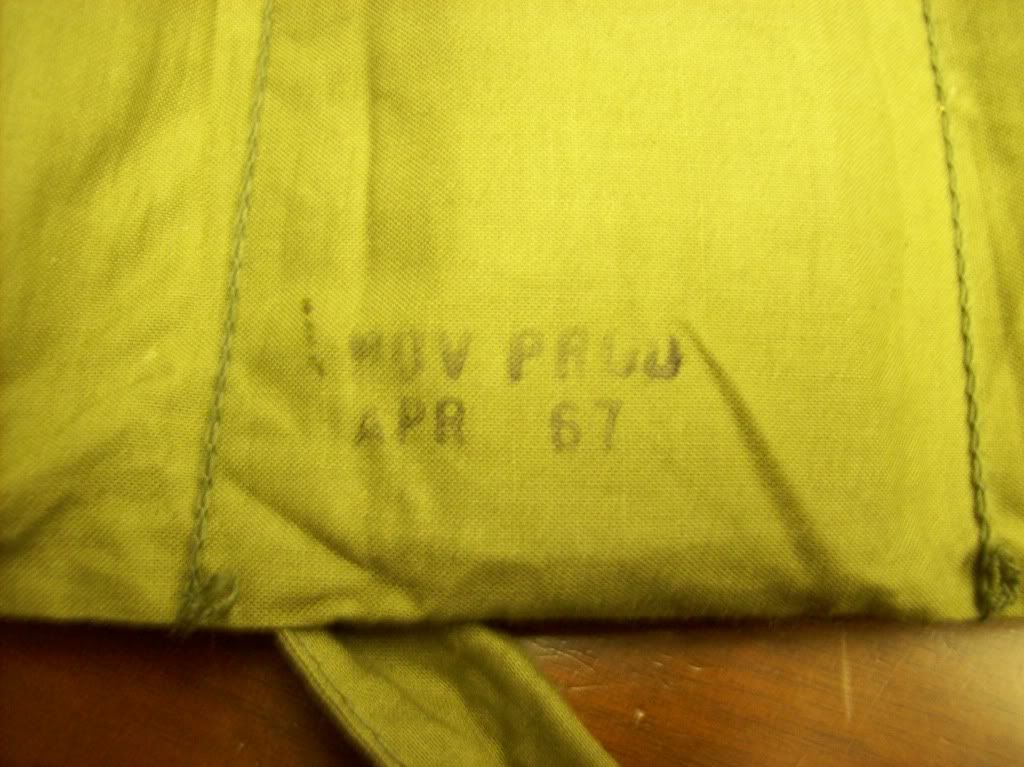

I need some ammo that I can take my garand hunting with? all I have is this
and not sure if this will do it?
anyone have some ammo out there that they will sell me so I can hunt with it? In the Jackson area? all I need is 8 rounds and I cant find any of the Hornady M1 ammo or is there another
