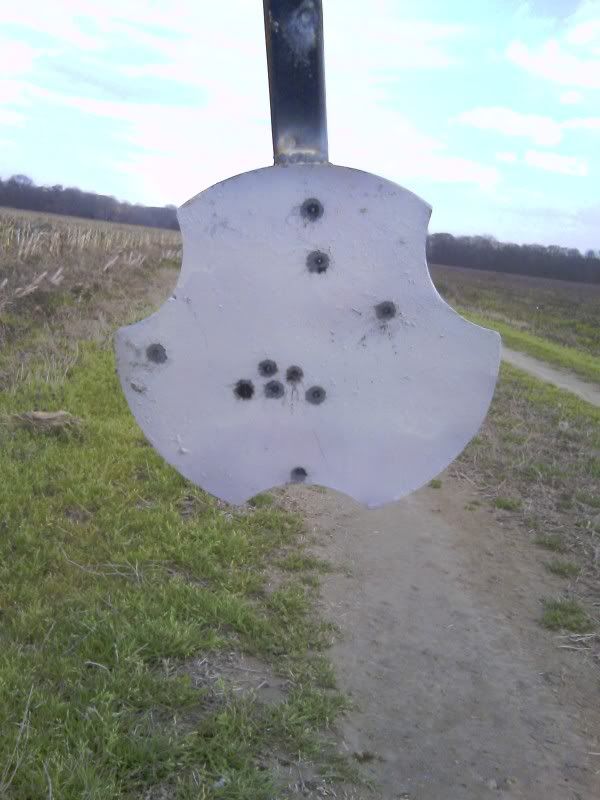

Since i woke up late and couldnt make the practice match i went out to the farm and blasted some steel and paper all day.
Wooden target is at 100yds and my truck is somewhere back there at 200yds.
I checked Zero at 100yds and worked it out to 200yds. SK Standard plus 1067fps -/+ 12fps in the 100rds i fired.
It took 18MOA to get it out to 200 from 100, only have 8MOA left in the scope. :(
My first 5 are in that fully looking group that zigzags, and the wind started picking up and i was just guessing and shooting. Im still pretty happy with the results.
Later on the wind got pretty bad, changing from 6oclock to 3oclock @ 10-15mph. I was having to hold 16" into the 3oclock wind.
This might help some people, its close enough to get on paper i think..
It shows 1000ft Elevation and 1050fps.. Im at 210ft and 1067fps so maybe thats why there is a 1MOA difference in the chart. 1MOA at 200yds is still on paper tho :D

Those 1st five shots look GREAT for 200yds.
Question..... The chart lists "Target Speed" at 10MPH.... Shooting a moving target....? :)
M1GarandFan, it is not where the group is.... it is how small is the group (scope adjustment). Wolf is standard velocity and your Federal is high velocity.

SGF, i found that over on snipershide.. they do some type of tactical rifle class with shooting from 25yds-250yds and a guy checked it and said its on the money..
Its close enough for me to get an idea.
Johnny, there is a 7moa difference in high velocity and subsonic at 100yds. SO if you sighted in with HV,, best bet is to come up 7moa and you should be close.
