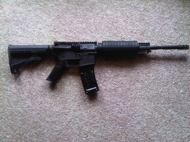

Finally put my CMMG 22 upper on the plum crazy lower. Snapped right on there. Changed the hammer to a blowback hammer to run the 22 per Joseph's recommendation. I plan to put some sort of red dot on it and some buis soon. I couldn't wait for optics so I cleaned everything up and took her out to the pond and fired off a mag full of Winchester 36gr hollowpoints with zero problems.
I realize that I could of gotten one of those conversion kits to fire through another AR or changed the barrel in another AR, but I wanted to leave my others alone and get the 1-16 twist rate. I can always slap another upper on this lower if need be.
•16" WASP Melonite Coated CM Steel Barrel
•1 in 16" Twist
•Mil-Spec 1/2x28 Threaded Muzzle
•Piccatinny Railed, Low Profile Front Sight Base
•Live Round Extraction
•Firing Pin retained by standard AR15/M16 Cotter pin
•Mil-Spec M4 Receiver with Ceramic Finish
•A1 Flash Hider
•Gas Deflector
Crappy cell phone pic:

Finally put my CMMG 22 upper on the plum crazy lower. Snapped right on there. Changed the hammer to a blowback hammer to run the 22 per Joseph's recommendation...
I'm not certain what you mean by a "blow back" hammer, but the stock P.C. composite hammer is .391" wide, while a standard mil-spec hammer is about .300" wide. As such, it would not fall into the channel of the .22lr bolt carrier for most .22 conversions.
You are correct sir.

A little update. I got out to the range yesterday with my Plum Crazy/cmmg 22. The rain/snow shut me down after about 1 1/2 hours. I shot over 300 rounds through it to break it in and site in my red dot.
As far as the lower, it functioned flawlessly....just about the cleanest break I've felt on an AR trigger.
I did have quite a few malfunctions which I attribute to the upper needing a break-in. The malfunctions decreased as the round count went higher, which seems to be the norm.
The Winchester 333 Plated 36gr HP had the fewest malfunctions, but the widest group. The Winchester HV 22 36gr Lead HP had the most malfunctions, but had the tightest group.
With my eyes and a red dot, 25 yds was about the max for putting them in a 1" circle. At 50 yds, a 3" circle was the best I could manage. I was just resting the mag on the table....not using a rest or vise.
I'm going to have to invest in a 22 mag loader and more mags and fill them up at home. This thing is fun to shoot, but I wore out my thumbs loading the magazines.

I shot a regular AR with a 22 conversion kit in it before going this route. It would light up all 8" of an 8" square at 25 yds all day long. That's still pretty good for plinking and a ton of fun. But, it just wouldn't consistently group....because of the twist rate I assume. Once I get this thing broken in and fully sighted in, I wouldn't be afraid to use it for critters. When I bush-hog my place in the summer, there are big fat field rats jumping everywhere for a couple of days. I'll have a surprise for them this summer!

The hammer comes from Plum Crazy. You have to request it when you order...or get it from the nice guy who's selling the Plum Crazy lowers.

The stock plum hammer is too wide to fit between the rails on the 22 bolt assy. I used the same hammer spring. No light strikes so far.
