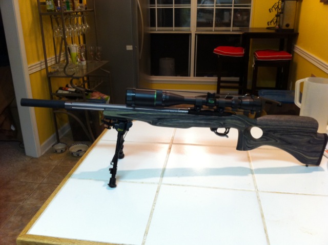

Ok guys good new! i just ordered a BSA platnium 8x32x44 ao scope from natchez shooters supply.com i believe that is a scope that someone recomended at one time for my 10/22 fclass gun. Please let me know if i made the right decision and if anyone has had any dealings with them could you tell me a little about how long the shipping takes thanks
Oh yeah I bought two caldwell 6x9 bipods swivel from accademy a little while ago they had them on sale $35 each so i bought the rest they had i think they usually run about 50 each. Also could ya tell me if i need a 15 or 20 moa scope base and what kind of rings do i need? for that bsa
On the 10/22 you shouldn't need the 20 MOA rings for shooting 100yds. You need 1" rings tall enough for the BSA 8-32 scope to clear the barrel. I suggest what are called "high" rings. Look on Brownell's website at part # 955-490-303. This is what I use with my BSA 8-32.

thanks guys i need to post some new pictures of it since i have gotten my new scope and rings on it and my volquartsen trigger group should be here today. when i get it in i will post some more pictures and i still havent had a chance to do any testing i have 12 different types of ammo to try in her to see which she shoots best.
good looking gun! my come from eabco.com its one of there accuracy series. I need to post some new pictures of mine now since i have my new volquartsen trigger in and my new scope and rings and base on.
How you like the new trigger? I've been debating on swapping mine out
man its awesome! it made a wold of difference i would recomend it to anyone. Midwayusa.com has them on sale right now for 189.00 in black or stainless. it is probably the best inprovement yet on my gun and my gun is fully custom everything that can be changed has been.
