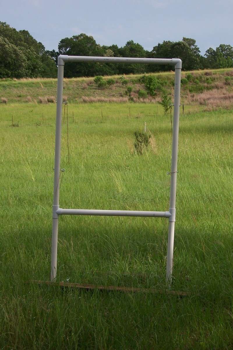

This is a great idea for a "cheap" target stand...I used heavier 1 1/2 inch PVC
The number of pieces of pipe is correct....the lengths to cut are off...If you draw it out on a piece of paper I'm sure you can figure it out.
Good target stands...If you don't glue it...you can replace a piece of pvc should you shoot it to pieces...I use stretch chords with eye hooks between the arms and use binder clips to hold cardboard...then put "dirty bird" targets on them.
Not gluing the stand together also allows you to pull it apart and put it in the back of the truck for easy transport.

Making a few of these is no biggie....Takes about 1 hr to make one.

That stand plan from Magnolia RPC is OK, but it's better to make it out of 2" PVC. If you make it from 1.5", you have to whittle down the 1x2's to fit into the pipe. If you make it from 2", standard 2x2's will fit into the pipe with very little slack but no whittling required.
Just a friendly FYI.
