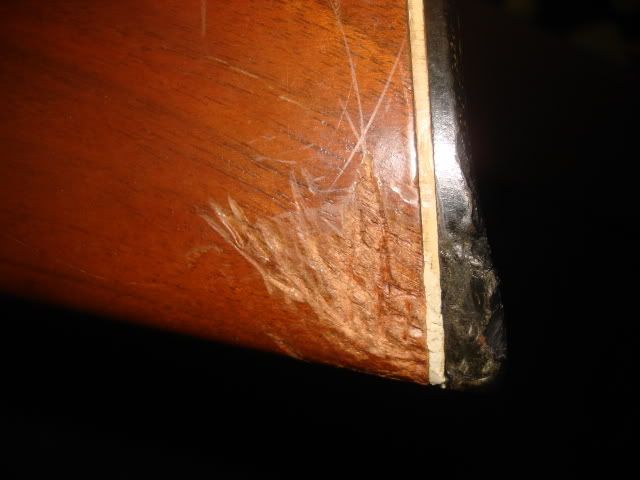

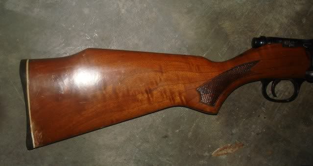

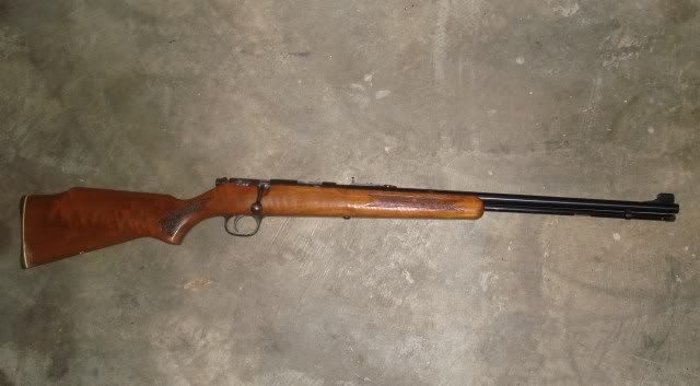

I bought an old Marlin 781 tube fed 22 from the pawn shop last year. My intention was a cheap truck gun but I became interesting in refinishing it once I saw how good it shot. It was literally chewed up on the end of the stock & the trigger group was rusted, but still functioned. The barrel showed some surface rust but no pitting. Total cost: $99
Before:

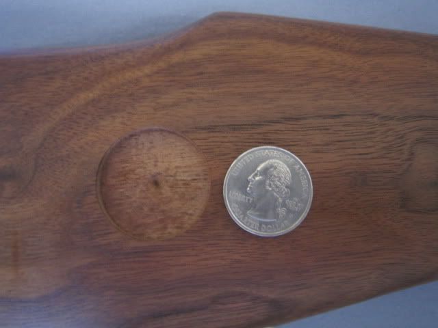

I ordered a replacement stock from Numrich's with a medallion cutout for around $50

Gun has been reassembled, sling attached & scope mounted. All that is left to do is mount the Liberty Silver Dollar I am using insted of the Half-Dollar.
