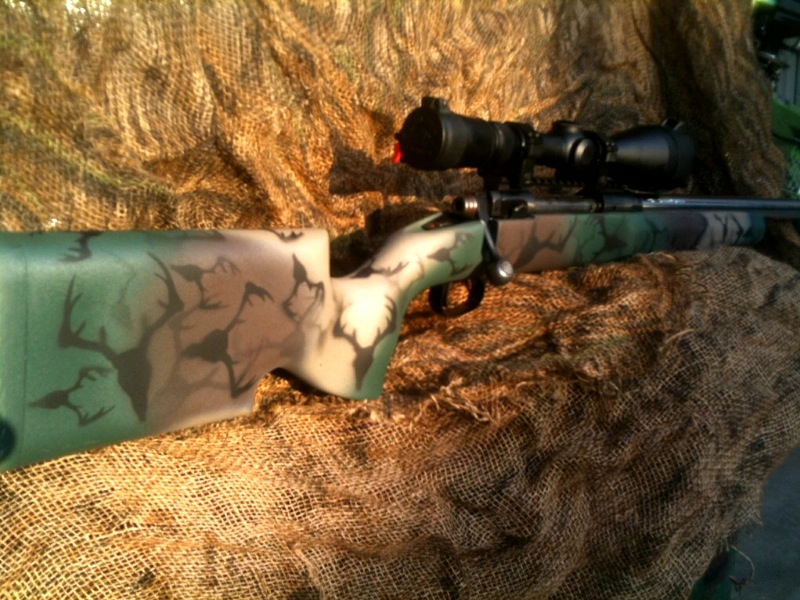

Oh yeah...Here's a pic of mine...she's still being "worked on"...Gotta get all the shinny stuff duracoated black
The business end:
You don't see deer skull paint jobs every day:
