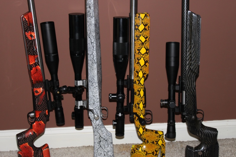

Now that is something I could go for -- maybe ... Really, really different and unique!!

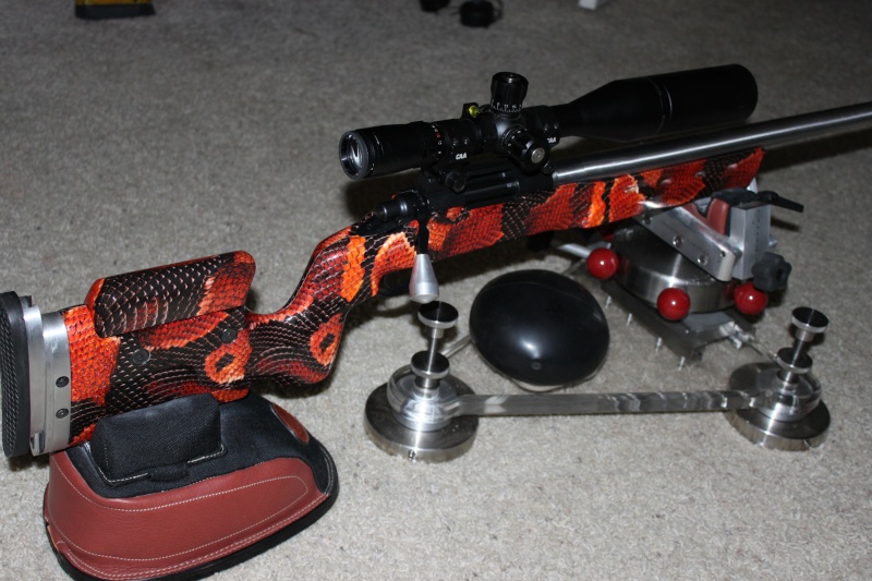

The red boa.....Make you wanna get squeezed don't it?
Man I tell ya...There aint much they can't do at Dixie Precision Rifles in Brandon.
www.1000yardhunter.com
Think I need to get the butt plate and the bolt knob coated Black and I think I'm ready to be styling for F class this year....
At least I'll be looking good....The red boa has 3 clear coats on it...Really brings out the scales dont ya think?
sssssssssssssssssssssssssssssssssssss
Ya'll get ya some!

Man those look great, fantastic! :thumbup:

Having a stock done is not as expensive as you might think....depends on how many clear coats you have done. The red boa has 3 coats...Think the yellow one has none. The more clear coats you add...the more the scales "squeeze" ya! LOL
The red boa is mine...
The other 3 guns belong to mstropyhunter....that white and blk one is a sexy 6mm brx
pm mstropyhunter...He can give you all the 411

The forearm I milled the angle off the bottom so it would be parallel with the action, and re-cut in for the rail under the fore arm. Cut cooling slots under the barrel channel on both sides, milled the bottom of the butt stock between the hook and the grip parallel with the action and made a aluminum rail to fit the Edgewood rear bag and epoxied it in place. Took some of the pieces out of the adjustable butt stock that were made out of steel and re-made them out of aluminum to trim some weight.
