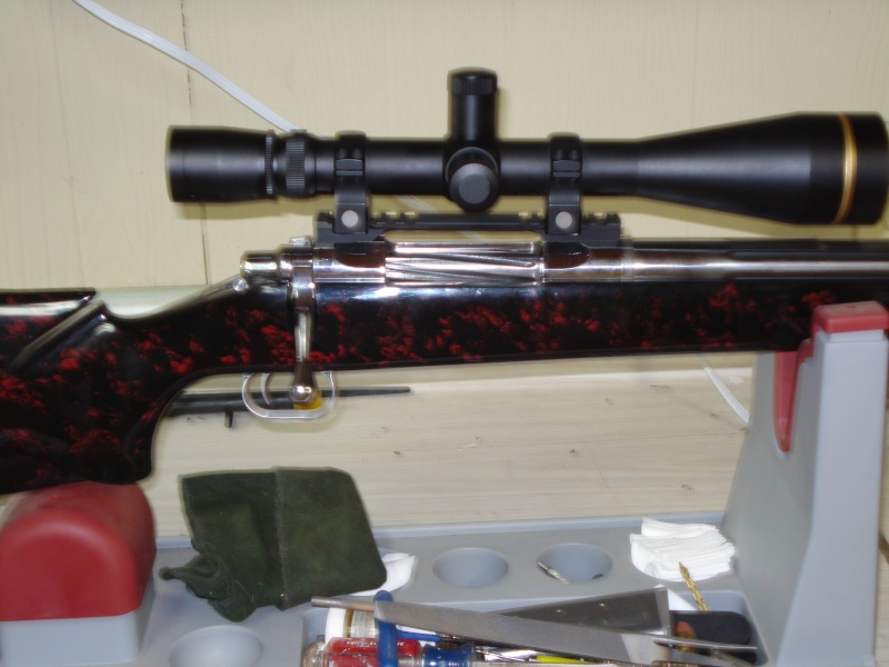

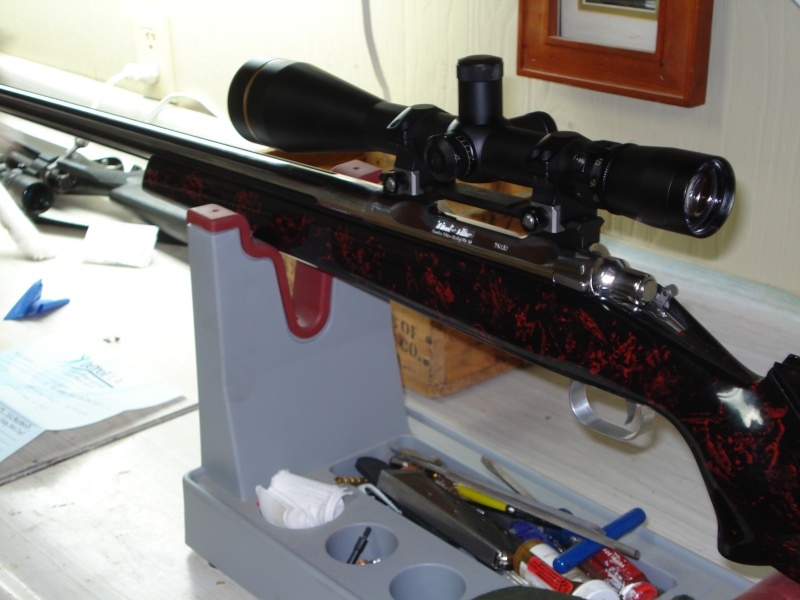

stopped by Tim's for some work on my 1911 and left with this.
borden action, krieger barrel, jewell trigger, Robertson Composite. Ferrell Base
25-06 AI
cant wait to take it out this weekend. will start fireforming if i can get some rounds loaded up.

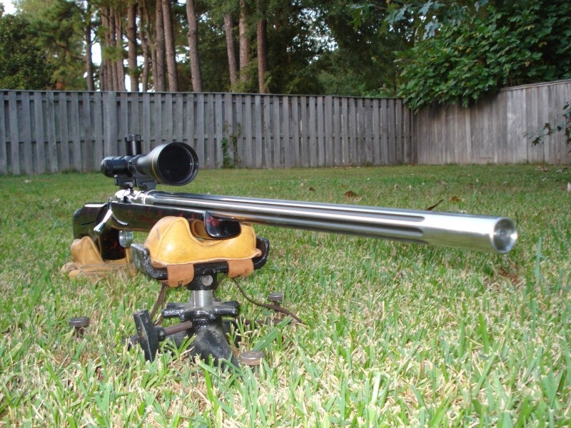

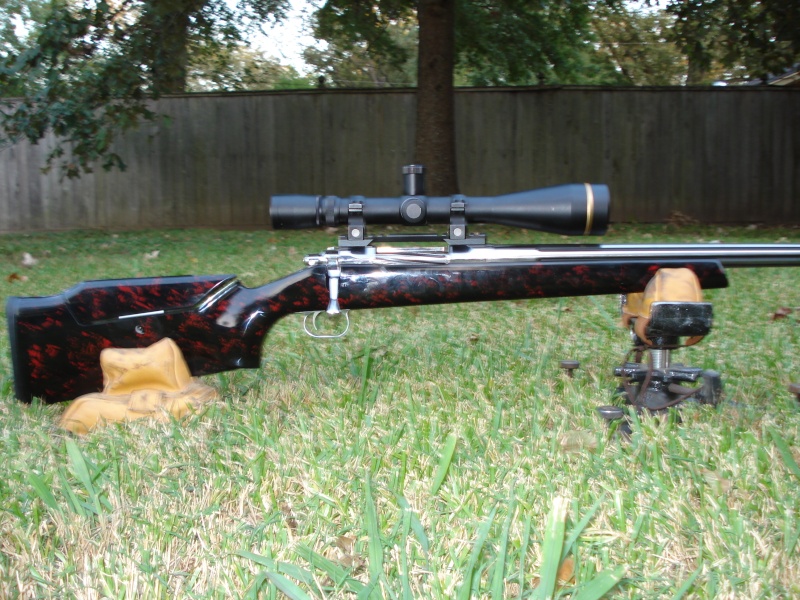

few more pics- loaded up a few rounds to fireform on sat. Cant wait. dang camera battery quit before i could get any more than 2 pics.
2

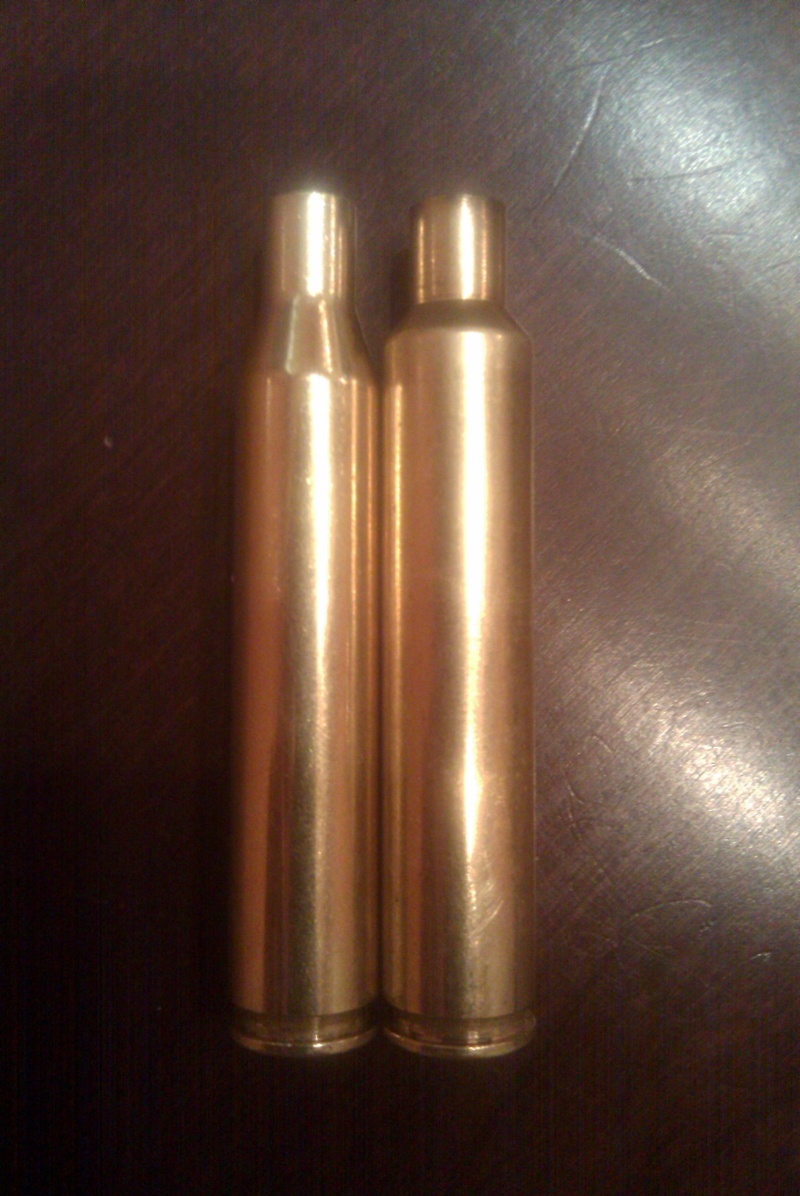

fireforming is going good,
The fireforming groups are pretty tight. they will start shirinking more once i load in the AI and velocity gets to 3500fps. here is 5 shot from yesterday,
shooting 100gr bt 3250 fps (reduced load given a good formed AI case) 41gr imr 4064 at 3.230 oal.
my AI dies should be in today or tommorrow so i will finish fireforming cases today, and start sorting brass and loading some tommorrow. hope to put a few AI rounds through it Sat but have a wedding to attend that may not allow it.
