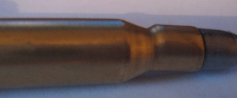

Ok - attempted to charge and load the freshly primed cases -- another problem .... Of course I did not use the depriming/sizing die to decap the brass. I took the decapping pin out of the sizing die and sized the cases using the die without the decapping pin in it. Since the decapping pin also contains the expander ball for opening up the case mouth, the case mouth was not expanded -- and here is the result. The case boolit has been sized to .311 and the case collapsed when the boolit was inserted.

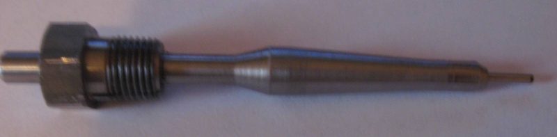

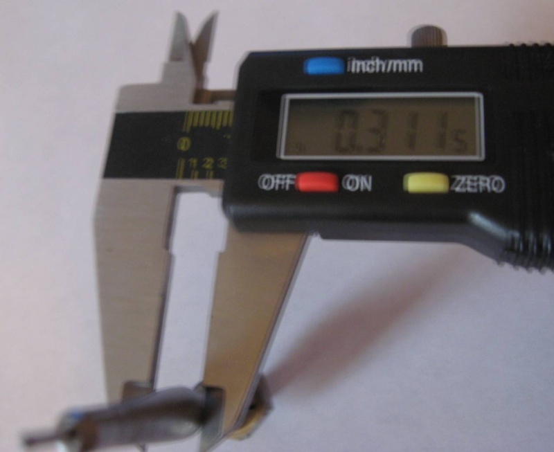

I measured the expander ball on the decapping pin and it measured .3115 -- just what I need.
Now to figure out a way to expand the case mouth using the decapping pin/expander ball. This is a set of Lee dies and the decapping pin can not be separated from the expander ball (unlike some Lyman and RCBS). Can not use this way because the decapping pin hits the bottom of the case and has no where to go due to this being berdan cases!
Guess I cut take a hacksaw to it and remove the decapping pin!! Any ideas out there?

If that pin is hardened a hacksaw isnt going to touch it. You will need a dremel or something else with a cut off wheel to do it. I can bring one of mine to the range one day if you want.
679 Posts
cap, since probably 95% of all 7.62x54R is berdan (I'm guessing) why not just grind the pin off totally?
If you come across boxer primed shells later you can deprime them by hand with a punch or perhaps with the press using some other similar sized case's decapping rod and pin.
